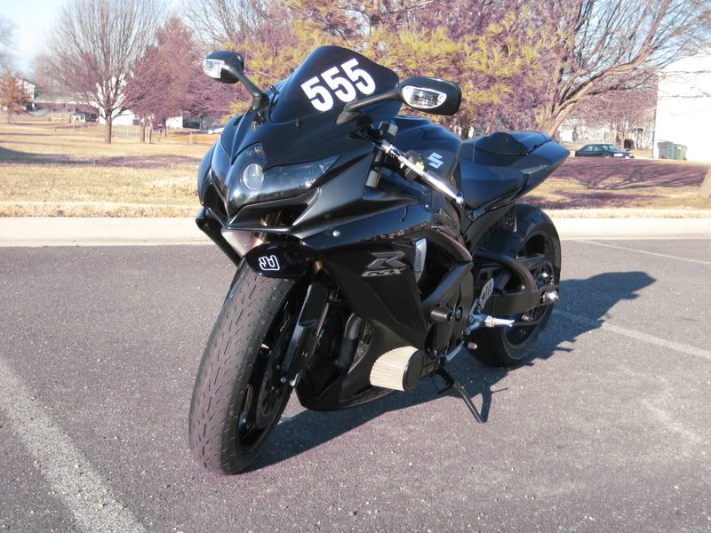

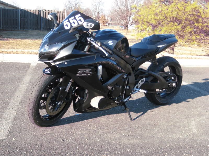

Posted 25 January 2009 - 07:59 AM
CraZee GSXR 1k said:
Id just put in a crate 1k motor.
I would sell the 600 and just get a 1K if power is your goal. Here is a turbo set up and the guy made less than what my bike puts down stock. Waste of money imo. Trade your bike in and get a liter bike if you need more power.
Dyno Day at HTP Performance 2008 Turbo GSXR 600 Video by ВЯӞҬҬ - MySpace Video
Posted Image
Posted Image
Posted Image
I would never want to ride a turbo bike anyway. Linear power delivery and turbo power are two very different things. I would hate to be mid corner and get unexpected boost. Get a 1k and do a big bore kit if you need power. 200 hp and its linear, imagine that?

stock airbox is no good, get a proper plenum. if the engine is the same setup as the 1000 there is a plug on either side of the engine that is a direct oil gallery from the oil pump for ur oil feed, give richard from rcc turbo's a call he knows his shit and is very helpfull. he may also suggest some specs for turbo sizes for the 600. power delivery at low boost on a 1000 is very smooth, but due to the lack of bottom end torque on a 600 id say the delivery will be a bit harsher. if u love the twisties just sell it and buy a 1000, also i talked with bazzaz about a computer for a turbo setup and they said they are NOT boost compatible...
that turbo 600 on the dyno is not very impressive, too big of a turbo it sounds like, half an hour to come on boost then 2 seconds till redline....
