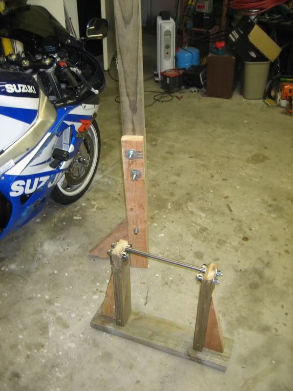

Here is the bead breaker and balancer that I made out of 2x4's
The bead breaker is just made to go on a stud in my garage with a piece sticking down to break the bead. You'll see how it works later on.
That balancer is made from 2x4's as well. Then I got some bearings and cleaned out the grease with paint thinner and used a light lubricant so that they spin freely.
I bought some balancer cones from www.nomartirechanger.com to fit on a .5 inch bar. I didn't use it when I did my tires this time though. I bought the bar at Industrial Metal Supply.

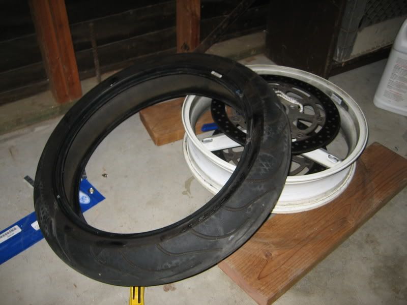

You can use your knees to hold the tire off of the outer edge of the rim. This allows room for the bead of the tire to be pried over the rim. Use the hooked end of the tire iron to grab the bead. Use RUglyde to lubricate the inner part of the rim and the bead of the tire so that it will slide over the rim when you are taking if off. Apply a good amount.
Use the tire irons to pry the bead over the rim. Use the rim savers to protect the rim from the tire irons. Sorry I don't have a pic with the tire irons.
Once you have the first bead over the rim you then have to do the same to the other bead on the tire so that the tire will come off completely. Note the directional arrows on the tire so that you can put the new tire on going the right direction. VERY IMPORTANT.
