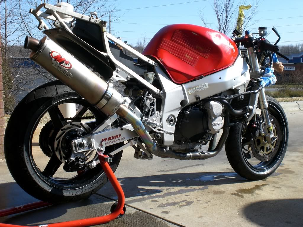

I bought the bike this way 2 years ago and never thought about the subframe until I tweaked it a couple of weeks ago. What I have seen on Ebay it looks like it has a 02 600 subframe on it anyway. Take a look.......

any subframe for the 01-03 gsxr 600, 00-03 gsxr 750 or 01-02 gsxr 1000 will work.
If you can find a deal on a used one.. i say go for it. There are only minimal differences between them and all of them will work.
Hopefully that helps you out!
